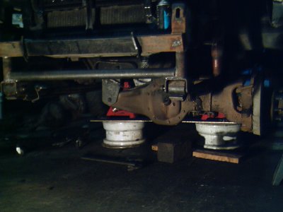

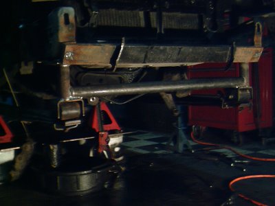

Well, got about half of the front done tonight... Remembered I should swap the oil cooler while the front end was missing, so didn't get as much fab work done as I'd hoped. Here are some pics of where I got too though... ;Sweet

386
I'm curious why you are using pipe instead of square tubing? Looks like your well on your way. How are you handling maintaining alignment?

I build alot of tube bumpers and other body armor out of tube, so I keep alot more of that pipe stocked around here - The pipe that was inside last night was easier to use than wandering around outside in the 28* darkness to look through my square tube :thumbsup: As far as the alignment goes, I measured alot of stuff before welding that in there - I erred on the side of moving the springs forward if anything, as these Fords tend to have tire rub on the fender side before the bumper side. I also mounted the springs slightly wider in the front than stock, which will make the rear of the springs with the shackles sit slightly closer together than oem - My tires rub on the back of the leaf spring but not the front, so we'll see what happens now. As far as caster/camber, I have a set of drop brackets from maybe a skyjacker 6" lift from some old project sitting around - so I don't have to build them :hail

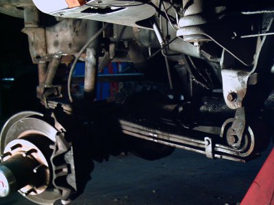

Disappointing night 2 - didn't finish my day work until 8, so I didn't have as much time as I'd hoped to put into the dually. Stripped my 4.10 front off the parts truck, and made a stab at pulling the rear shackles off the parts truck - they weren't cooperating and I didn't want to fight with them in the dark. I need the shackles for the back of my front springs, but that will be wednesdays problem. I installed the center drop brackets - 3 out of the 4 bolts that hold these to the engine crossmember stripped, so I just plasma'd them off and welded the top of the brackets in place. I also got the 4.10 driver side mounted, which will move again when I get the shackles off. Was hoping to have most of the front wrapped up tonight, but that's how it goes... I was also hoping to get some daylight to work outside. A couple (bad) pics...

Night 3 is over - finally got the front to where I wanted it on monday. I probably spent three hours dealing with bolts frozen in bushings! -cuss Both of the dually's rear spring bolts stuck, and one of the shackles off the donor truck were stuck in as well. Done dealing with that now though - Got the shackles mounted, lowered the shock brackets, built the reinforcement bars for the drop bracket that holds the front of the springs, bolted the passenger side TTB back up, reinstalled the brakes and other stuff I'd disconnected... pics of where it sits now - and happy T-day all!

only question i have is with the weight on the trk is the shackles for the frt axle still straight up and down? if so that is really going to give you problems. the shackles have to be at an angle, if not the spring and the shackle wont cycle correct. when the spring cycles, it gives, which in turn it stretches and the shackle moves to allow it to stretch. with the shackle straight up like that the weight will let it go to one side or the other but it wouldnt let it go back to center. i also believe you are going to have problems with the frt spring bracket you made. dont get me wrong i like the idea, but that bracket has to take a lot of stess and i dont believe the way you mounted it to the frame will be strong enough. if you take it offroad at all i think you are going to rip those welds apart. think about the weight of your trk, the amount of force it makes when its pushing its weight at speed, through any type of mud hole, or for that matter the force at speed it has when it hits a pothole on the street. the pipe should work, but the way you mounted it to the frame is what im talking about. if you would have boxed in the frame on the frt/then made a bracket that went half up the frame then i believe it would be strong enough. im just saying i dont think its mounted to the frame strong enough. i could be wrong. i hope so. but then again what if they do fail, how much damage will it cause, or for that matter where will you be at when it fails.

Mudkckr- Definite good points. Honestly, I don't like the idea of using the stock rear shackles for the back of the front springs - especially not after I pulled them out of the other truck and was reminded of how dinky they are. I don't know how they will sit when the weight of the truck is on them, as I haven't gotten that far yet. I will drive it with that part of the setup this weekend and see if they are functioning as they should or not. I think I will probably end up making my own, as they have a little twist to them now that I don't think will completely go away when the suspension settles. At that point I will move the mount at the frame if it feels like the shackle is not moving correctly. You can usually feel the binding you are talking about from the vertical shackle when operating the vehicle. My personal experience has been hit or miss with vertical shackles, if it works or not also has to do with the angle the spring is mounted at and the load of the spring. I've seen vehicles with vertical shackles that bind so bad that it will break spring packs, and I've seen vehicles that have gone through 2 years of hell without issues from the vertical shackle. As far as the front goes, I am concerned about the strength of the two bars as well - I fully intend on integrating a couple of more support bars from higher points in the frame down to that bracket. I was avoiding boxing in the front of the frame to "streamline" the appearence, if you will - I don't like how massive the front of these trucks are stock, and if I had built the drop bracket out of box steel that joined into the boxed frame the truck would have a 3 foot tall flat front end. I'm hoping to integrate the bumper into these supports as well, but if I don't feel like its strong enough to drive in any condition I may get myself into, it won't go far.
