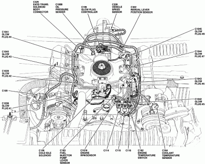

342
OLDBULL- neither the old-old or new-old high idle solenoid that I had on hand could be made to function even with a direct connection to a battery (they ARE just 12v neg ground solenoids, right?) anyway we are currently solenoidless.. After I get the P/S belt on tonight I'll take him for a ride to warm up and adjust the idle down as you say.
The Hi idle solenoid ( Batt. +) is connected thru a temp sensor on the pass side next to the #1 GP, the temp sensor is NC and opens at 120* head coolant temp. You have to set (help) the solenoid plunger extend by pushing the go pedal down one time with the key on before starting.

Yessir, that's SOP for cool/cold weather starting, more specifically I was stating that I could not get either of the soleniods to actuate even with a designated hot wire from the positive terminal of the battery to the contact on the solenoid, with the body of the soleniod pressed firmly against the negative battery post. Then, I was asking if it was actually a 12v solenoid, with the implied but unwritten question being "Or is there some other lower voltage that is actually supplied to this thing somehow and have I just toasted the **** out of it because I stuck it straight to the battery like an idiot?" Surely you could see that, right???LOL
385
Sounds like the solenoid is bad. It runs on battery voltage. You can't hurt it by hooking it directly. Ohm it out, and I bet it has an open circuit or high resistance. You'll need a new one if you want that functionality back.
