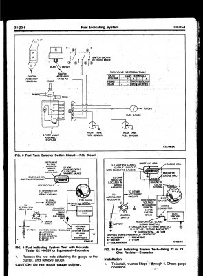

342
The senders are no longer available for these older truck. Your best bet is to drop the tank if it's the rear one and try to see what is wrong with it. It could be the wiring on the connector or just all corroded up, or the slider on the resistance cam. It can also be the connector on the FSV. The diagram below is for a 89, but will give you an idea what to look for.

You have a LOT to check/test/eliminate before punting to an aftermarket gauge. If the PO did any shenanigans with the selector valve, that's very likely the explanation of the inop gauge, since the gauge feed goes through the selector.
385
Isspro makes a good gauge. I carry them here. But I'm willing to bet you don't need it. Have you ruled out the tank selector valve? That has to carry your electrical signal to the gauge, and those things have a history of being a problem in that area as well. Also the factory gauges in the cluster ARE replaceable, and I'm sure quite a few of us have them laying around.
