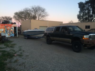

short work day today, but i got my FMIC mounted!
time to hit the beach!
[/QUOTE
HIT THE BEACH!! You had to rub that in!
i dont know what your talking about....-Showtits LOL
i did bring home a new project :D
