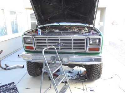

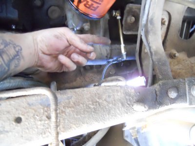

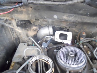

Here is some pics. not done yet, yesterday was a pain, i had to run around to get some fittings so I could hook up the oil feed line, I ended up tapping at the oil cooler instead of the far rear cuz that plug is now permanently part of the block. the up pipe and down pipe are in and it appears my engine is sitting as far back on the frame as possible so it is really tight back there, even with the metal i cut out.
