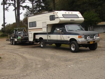

here is what I haul and I have power and decent mileage. 11 mpg light foot ,but if I want or need to get there I drop to 4th and hammer down, then I get 10.
GW about 13~15K depending on length of trip.
My engine pulls best at 2200/2300rpm 6 lbs boost 65 in 5th ~58 in 4th. Heat is my problem
