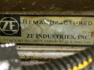

The seller couldnt remember if a reman transmission was installed with the engine, well, it was. It was a fleet maitained vehicle for an electrical company here.
