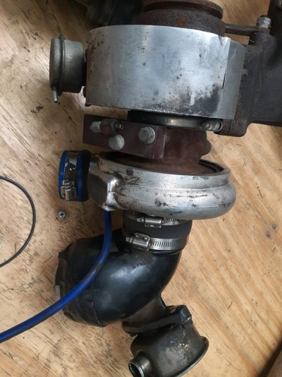

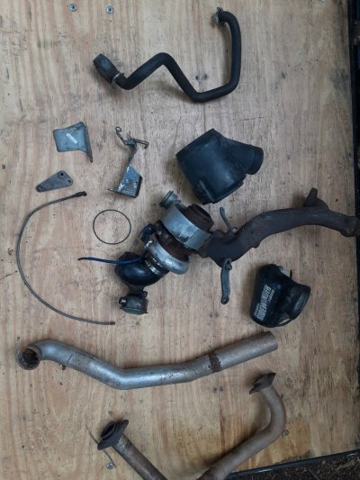

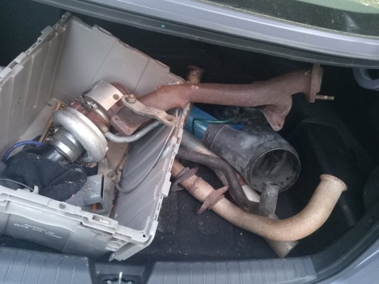

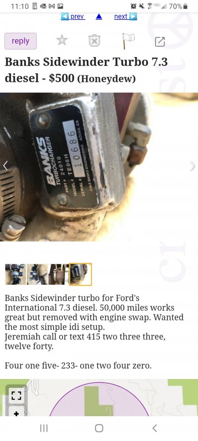

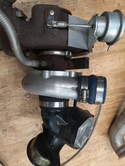

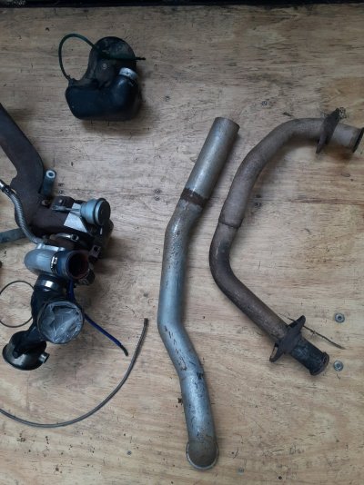

This was the ad and subsequent photos I got from the fella

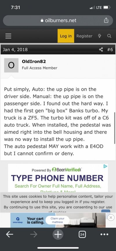

I can't quite tell by the photos, but the banks kits are transmission specific. I hope you have the correct kit for which trans you have. The pedestal's are different

Let's hope I do! Didn't know that
4,209
4,793
I found that out the fun way.... After I was installing mine. Had a kit for a E4od, and I have a zf, didn't clear the bell on my trans. I'd suggest before tearing it apart, find some reference pictures for each trans with the pedestal. I think they're in the manual.

Word, I dl the manual I'll check it out. Ty

Research telling me;

Do you know what the truck had the kit came off of? I don't know if the c6/E4od are cross compatible, on Bank's website they list 3 kits, for each trans option.

I don't but I asked the fella and am waiting to hear back

He had it in an 89 7.3. I'm not sure which Trans were used for that series
