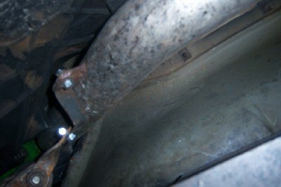

If you bought the downpipe with the *bracket* , the bracket is the little metal piece with the half twist , but it still won't reach anything with the 088 kit . If you look in the picture you can see what I did, I used a piece of flat bar and bent a 90 deg and drilled two holes and lined those up with the * bracket*
If you got one that slides in you will need a tube of exhaust assembly paste to keep it from leaking at least you didn't have to spend a few hours grinding yours to get it to go in.
