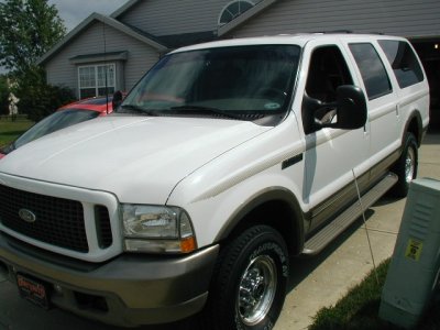

I like is also.... looks good, but I was thinking along the same lines as Waystro..... the older style is more rounded, and may be a better "fit", style wise.....
My white Excursion has the mirror in "Standard" position, and the dark colored Excursion is extended out in "Tow" position.
This is the 99-07 style... notice how the mirror head is more rounded.... this does make for a bit smaller mirror surface..... but they are much bigger than the standard 80-97 mirror.
Here is the "business side".....
Notice the curved top mirror, and the slight smaller bottom convex mirror. Trust me, they are a very nice mirror to have........ once they are adjusted, you can see a car out of the corner of your eye, out the window, and still see it in the convex mirror.........
For those that like the look of the chrome mirrors on the older body style, that's an option also......
