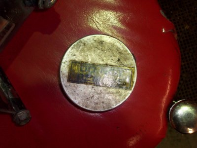

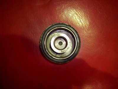

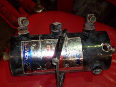

HEY BIGRIG this is what im using i dont have my camera here at work but ill explain it to you but ull know what im talking about though
its off of a 92 FL its the fuel heater that uses coolant and theres a filter that goes on top i believe its an ff 105 anyway i had a secondary filter block off that went on the 3406E and used that to block off that filter part and it was all free just got to get the fuel fittings and stuff

mine is a fuel pro also but here is what it looks like and there is the fuel filter block off plate or what ever u want to call it and i got to looking at what i posted eariler in 92 they didnt have the 3406e im retarted it was the 3406C sorry guys

im not really shure i should look that up but i think it just heats it up to the coolant temp
speeking of 12v heater ive got another one that came off of century class that has one i think but it have the coolant rolling through it and its one of those stupid fuel filters fs 1029 if your famailiar with fleet gaurd those three piece things but i think my block off will fit it havent tryed that yet
