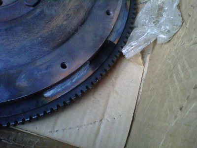

Here it is. It looks like it will hold up fine. I guess I will find out. I left it all together before he welded it because I didn't want to mess anything up. I am going to try to cut out the springs with a angle grinder by cutting in a few places and pulling the pieces out so nothing is rattling around. I am sure it won't be completely balanced. I had him weld right where the pressure plate bolts to in six places.
Nice looking job. THey welded it with good penetration and have roughly 2-3 times teh surface contact area of the bolts holding the pressure plate on. If it balances out, I don't see why it would have any trouble. I don't know if they balanced it, but a simple tire bubble balancer would tell you, and I imagine you could atach those stick on wheel weights on teh backside to balance it.

Yeah you can tell it was a hotter weld its not all smooth and pretty but it penetrates good. Ok that sounds bad but anyways if it all works out I will have about 180.00 into a "SMF" conversion.
or grind a little if its pretty close. If one of the weights came off it could get interrestin':eek:
good idea--but nuh huh--toooo many rpms!!! wayyyyy faster than a tire--but any good machine shop could balance it--if they do engine balancing
If it balances out, and IF its not soft as a
from being annealed from the heat of welding.
I will be interested to see how this turns out!
