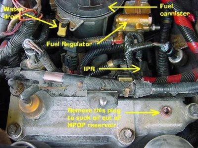

where is the hpop reservoir? I prolly need to fill it manually
338
The HPOP will fill when cranking, but you can fill it, only takes about a pint.
Where it says SUCK, it's also FILL.
