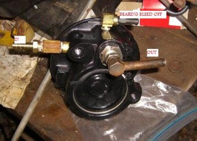

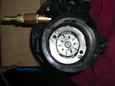

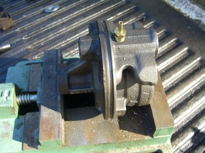

i used a ham can style chevy powersteering pump (actually left over from my jeep) i dont have it all together and working yet so these are just some teaser shots:D

well, to start i put a pic of a un-modified pump. not mine, mine was much more grungy and dug from a parts pile. i didn't get any pics until i got it apart and figured it might work.
i then drilled out and tapped the inlets and outlets. it looks like i actually have 4 fittings but two of them are looped together. there is a opening at the front of the bearing before the shaft seal that would just drain back into the reservoir. obviously since i don't want the reservoir anymore i cant have that so i looped it back into the inlet side. so that leaves me with just an inlet and outlet after that.
a trick i have to give to Jeff (guy from the link) is removing some of the wafers to back down the pumping ability. this pump is HUGE compared to a holley or carter aftermarket pump. i am only taking a guess by running half the wafers and i will see where it takes me. you will HAVE to run a good external regulator WITH a return line to bleed off the extra.
