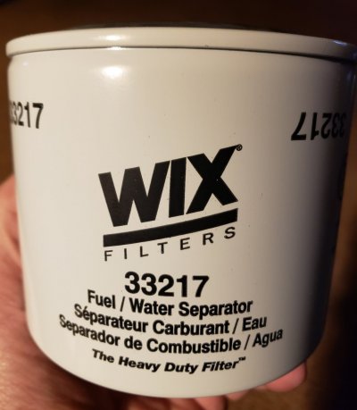

So I got this in from RockAuto... for the decades I used Purolator or Motorcraft but no one stocks them anymore... just Carquest.
Anyhow... I've read where some fill the filter with transmission fluid, start the engine (smokes like crazy) then shuts it off to act as a 'soak' for injection nozzle tip cleaner.
If I recall correctly, the once famous Oil Burners 7.3 forum moderator (Mel, I hope he's well) and creator of the Moose/baby Moose Pump more/less stated that the ATF doesn't really get to the Pumps advance piston to help that.
Anyone here filled their new fuel filter with ATF for a cleaning-soak and noticed any benefit???

The wix filter does fine.
Always fill the filter with something, of course....but ATF won't do any harm. Filling the filter with ATF, or an additive of choice can potentially help with clearing up some issues like a sticking metering valve, etc.
Go for it. You likely won't notice much of anything aside from maybe a burp or two as the injection system processes any air it might have ingested. nor will you notice much more smoke than normal.
