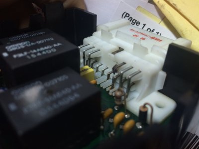

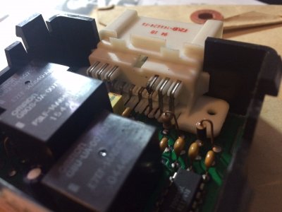

I took the switch apart and cleaned the contacts and also got a reman wiper motor and just plugged it in. No difference. I have no wipers and no washer pump anymore (after fixing plug wiring). I can hear my relay clicking under the glovebox, but considering I lost all wiper activity I'm still kinda thinking it may be the issue?
jhenegh
Truck Still Earns its Keep
Jul 7, 2013
1,072
36
Deerfield, WI
I'm not much of an electrician (big reason for IDI ownership!!) but I don't think broken and burned connectors carry current very well. I'm shopping for a new wiper relay or wiper governor now. It seems to vary in what they call it online...
Bought 2 used relays off eBay. That fixed it. Extra one went in glovebox
