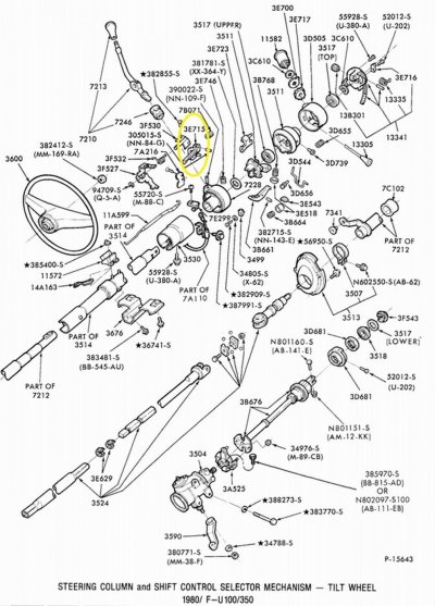

Yep, this is a classic problem especially with the older trucks. I had a 1980 that during cold weather I would have to lightly wiggle the keyswitch to make sure it went back to the proper run position. If I didn't it would keep running but random things would not work. Like the fuel gauge and the wipers, etc.
Like you I eventually replaced the ignition switch, and flooded the upper column with wd40, and the problem went away. Before the wd40 I would have to take both hands to turn the keyswitch in very cold weather.
