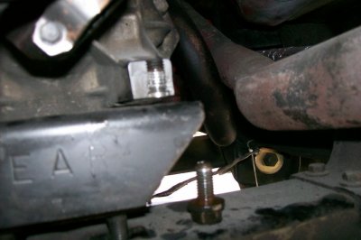

I was trying to remove the bolt to loosen the tranny and the f#k!ng thing snap in two even with the tranny lifted a bit it would do the same, the manual doesn't say anything about doing it different either.
Welder please shed some light here too as I might have to go that route or drill another hole and tap it?

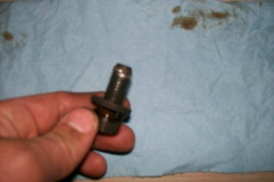

After some further investigation I see the bolt has some kind of material on the tip which what caused it to snap the threads on the tranny, My guess is that the other one will do the same, should I finish removing it? I still have some space on the tip so I could drill it and tap it or hold it like You Nick until I get it welded?

The bolt on mine was the same way, I heated the other boss and let it cool and it came out with some lube.
That buildup of material that you see is galling of the aluminum onto the steel. My guess would be that the bolt was hard to turn when you were trying to remove it. The more you turn the bolt the more aluminum it picks up which is why you see those areas where there are no threads left in that area where the boss broke. As far as removing the other one... how hard is it to turn? Once they are broken loose they should pretty much spin out by hand unless there is some binding due to mis-alignment. As OMrBill said never sieze etc is not a good choice where you have dissimilar metals he has mentioned one good option and I have had great service using Permatex 14H which is a teflon paste. I have seen steel or SS bolts into aluminum threads that have been in salt water for a number of years spin out like the day they were installed. A lot of broken bolts/knuckles and extensive repairs went into finding a good solution so I hope that helps. Let us know how that other bolt is spinning. As far as repair of the damage, if you have someone who is good at aluminum welding it won't be too bad just make sure it's CLEAN before any welding starts, re-drill and tap a new hole and you're ready to go. Did I mention it needs to be really CLEAN? :D

Ok I got it all back together now ;Sweet . I managed to remove the other one with heat so one side is still in one piece. I put two longer grade 8 bolts and drilled the threads out of both holes, then put some jb-weld (?) to hold them together until I have it welded. Hope this doesn't make it worse since The main idea this morning was to just put a new tranny mount to help the vibration at idle.
