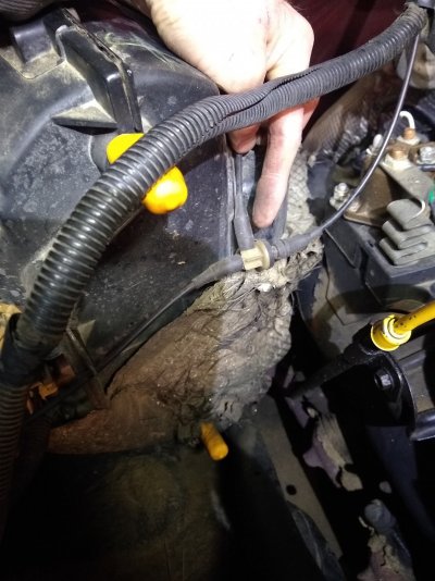

Wonder what these parts are, something to do with the air conditioning? I'm pointing to the "lines" in the one photo. Just wondering if I can remove this stuff I no longer have air conditioning.

The round gold thing is the inside/outside door actuator. Your heat and A/C normally pull outside air from the grill below the wiper blades. But when you select "max" on the selector, that sends vacuum to that gold actuator and it switches a door inside to pull interior air into the system instead of outside air.
Can't tell on the vacuum lines. Have you traced them out?

Haven't traced them, was changing the GP under the turbo and was just try to think what this stuff was. Thanks.

If it is like my 93, they go to other parts of the heater/AC system.
FYI, at least on the OBS body trucks, cruise control is electric, not vacum
