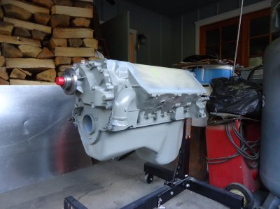

I used PPG Omni epoxy primer, then top coated with Acrylic Urethane Enamel that used a hardener. So far it still looks good (two years). I tried a high heat POR 15 product on the exhaust manifolds after sand blasting them and it has failed. The exhaust ports on the head get too hot for most paints. I would try the VHT paints where there is heat like exhaust manifolds, or better yet get them ceramic coated. I thought the intake manifold looked good with the raw aluminum so I clear coated it after using an adhesion promoter. It still looks good two years on.
Edit: sorry about the pic size. Right click on pic and select "view image".
