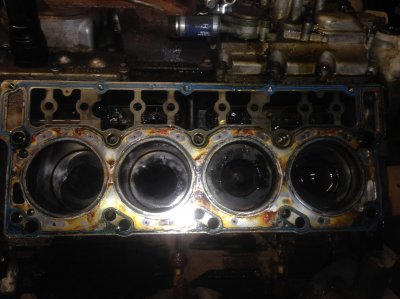

Excellent show of head gasket failure due to the lack of clamping bolts.

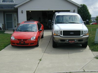

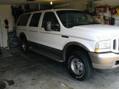

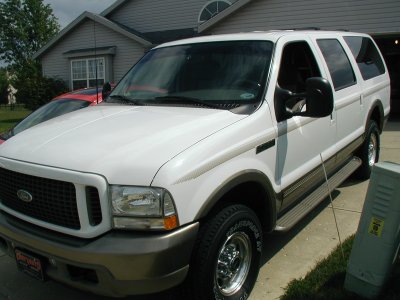

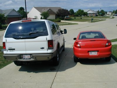

As for pictures, here you go...
