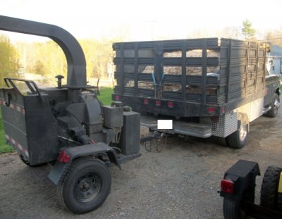

i had the guys over at FTE help me out with my install.after completed i took her to work.here was my first impression:
this is great guys! im extremely impressed.
grossing about 13,500 here in the pics today.
this truck now goes (turbo) as well as she stops (hydroboost.)
it's just like driving a 7.3l psd truck (a stock one) if not better! (it's been a few years.)
she starts out easier,goes down the road easier,and pulls a hill like nobodies business.
one hill i commonly go over,which puts me WOT and in 2nd gear when loaded up like this as n/a was at 40-45mph and screaming.
now boosting about 8-9 lbs WOT she took it with ease in 3rd @ 55mph and would had kept on climbing (and fast i might add) had i not backed off her about half way up!
just driving down the road 45-55mph in OD without any real load/boost gauge reading 0 trumps N/A - seriously.
