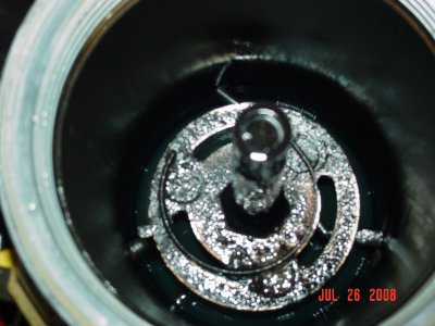

since he dont know about electrical stuff i think somebody should tell him where the plug is to unplug it?
on the drivers side of the fuel filter housing you will see 2 plugs.you want to unplug the top one and the fuse wont blow again.and as stated you dont need it anyways.but if you want it to work convert to the 99-03 fuel heater.its supposed to pretty much drop right in with no modifications needed.i think you need to turn the plug a little to pop it through the hole in the housing.

actually i think im wrong on where the plug is a little

you can completely remove the heater element if you wish.unplug it from the inside and remove the black platic stand pipe.the pipe has LEFT HANDED THREADS ON IT!!!! turn it to the right to remove it and to the left to tighten it!!!once the pipe is out pick the heater up out and put the pipe back in being carefull not to over tighten it and break it.the heater isnt needed unless your in alaska or something.

No rich your right the plug is about halfway up the driver side of the fuel bowl
thanx.;Sweet;Sweet its been a long time since ive actually seen one in person as my PSD has beans electric fuel system and beans stealth dual HPOP so my filter has been gone a long time.and i dont have another truck here to look at to make sure i gave the correct location.
