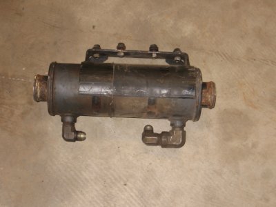

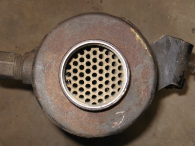

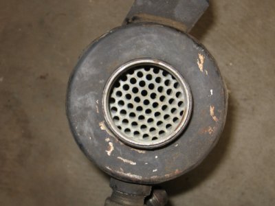

Here're some pic's of the water to oil trans cooler I'm going to run on my ride.
Steve
Steve
Haha, cool!! That thing is neat... what's it from?
