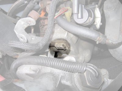

Here's the boss on the front of the pump for adjustment...

Yes, that's it, exactly what SUV7734 posted, I was actually looking for that pic last night as it helped me when advancing mu pump, but I couldn't find it.
It's right here on my camera's memory card... LOL
Hope it helps

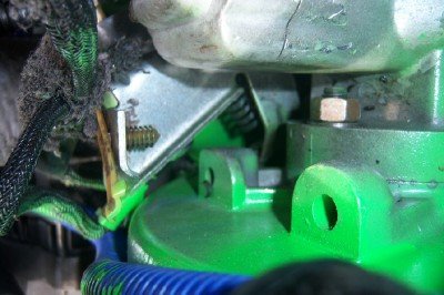

'Cepin they don't all have the mythical pump boss.
I've got three pumps around here and none of them have it. all are later 7.3 pumps
Here's mine:
374
I can't recal seeing many with that boss either.
