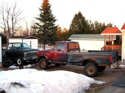

I've got to get some good pics of it's current condition, but, here's a couple.
I upgraded from the old bench to late 80's EB Bronco Captains chairs... My butt thanked me for that...
And, yes, that is a 120 gallon fuel tank in the bed...
And, FWIW, that's the 460 truck to the left... poor thing hasn't seen the road in 2 years...
