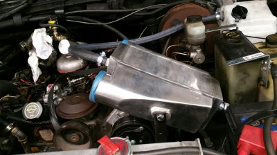

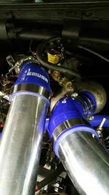

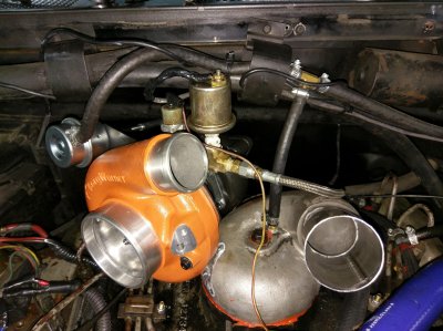

I had trouble getting my intake hat off, but I'd try what IDIOT said, he's had more turbos off than anyone probably. Certainly more timing covers :) With a larger turbo you can see how close the snail is to the compressor housing
