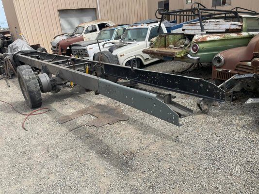

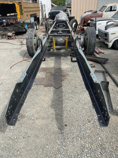

moving the rear diff back 5 feet
fixing a weak frame splice while im at it

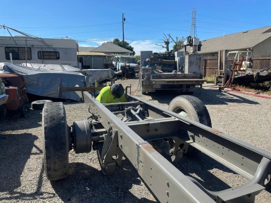

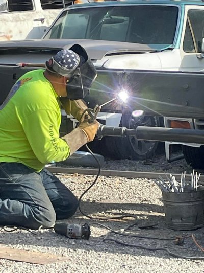

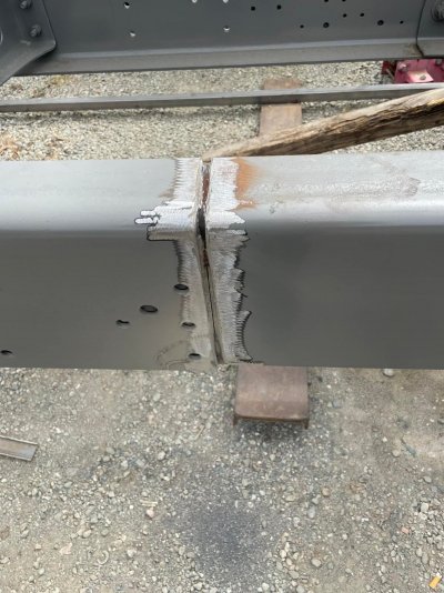

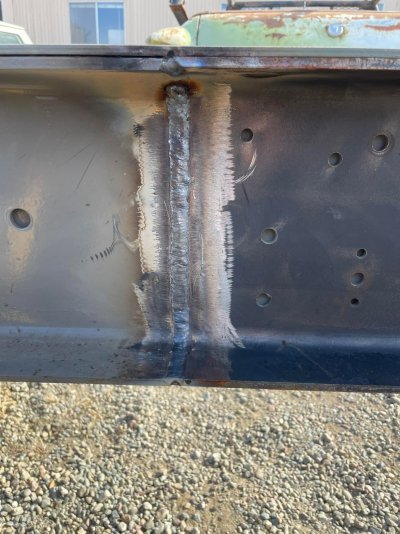

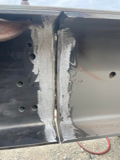

my buddy hooked up the frame welding today,
im just a hobby welder, so i called in for reinforcements from a professional.

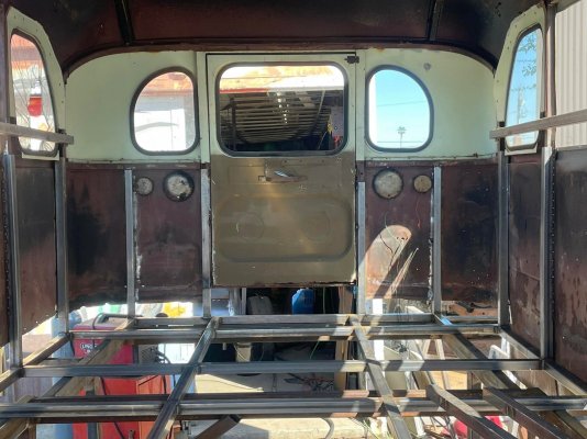

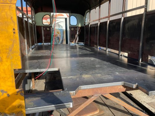

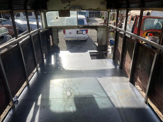

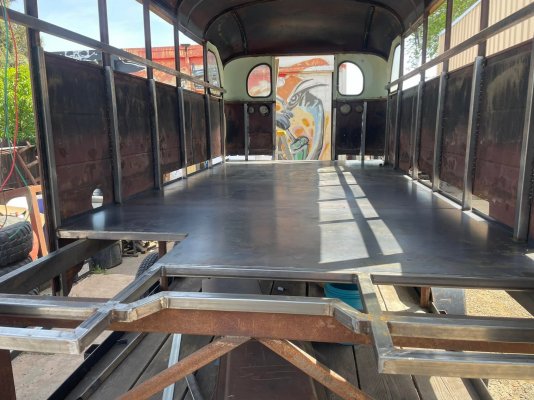

also finished my vertical pieces

I've always been told to angle cut frames for more weld surface area. This is double framed inside too. Your buddy is one hell of a vertical arc welder.
thats how i do it on light duty single frame trucks,

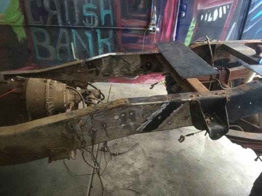

Half lap was once the way to go also....
so let's do the real world failure list rather than "do it this way" discussion:flipa!
Nice forward movement man!
Tail wag would suck with the stock wheelbase.
