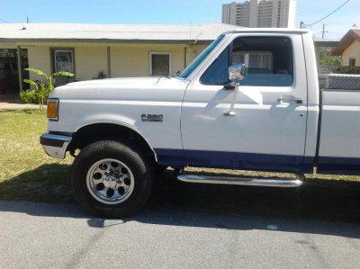

few pics so far
as you can see camber is horriblleee:puke::puke:
and bottom spring is superduty top is gasser 2in lift coil

Thanks for the compliment.
I couldn't tell you I dindt measure them.
I can say this tho. Before hand I had about a inch between top of tire and bottom of fender and you can see now.

ya u got like 3in out of them i would loose the sway bar and aline it and call her good

The shop I went to said therevwas no way for them to align it without some kind of adjustable camber bushings adjustable ball joints or drop brackets.
So right now I'm looking for a set of drop brackets for the I beams.
Curious. What's your reason behind saying to ditch the sway bar? It fits just fine.
