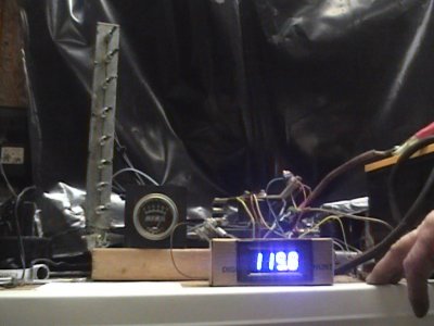

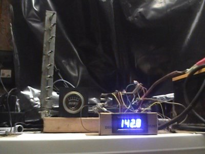

Gonna buy a set and check them out. Not in a truck just now, but on my tester, then maybe later in the 92. I'll make a U-tube video when testing.
Edit: Ordered them. $55.94 shipping and OH tax.

To quick with the questions, won't be here until Apr. 3. I don't know why anyone would need an O'ring seal, I'll see. They show a tapered seal.

The claim is that there a new design with dual elements and heat controlled, that's why I'mm gonna check them out for you guys.
Edit: I'll be sure and put them thru a rigourest testing.
