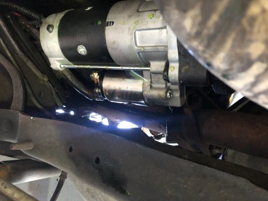

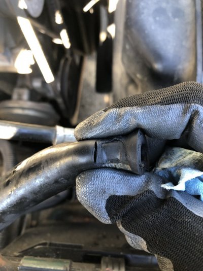

Had to fix a little coolant leak before work today… only took like 90 mins to get on the road again though. No oil on the new starter but plenty of coolant haha. The hose o the passenger side that routes into the cabin had a split.
Have been meaning to coolant flush anyway and put in the precharged sca Napa stuff so will get on that soon. Had to add less than a gal or water to top things off.
