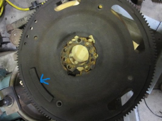

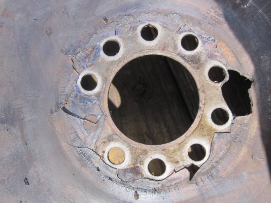

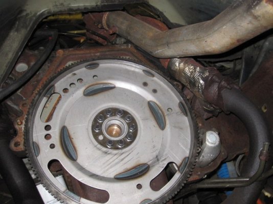

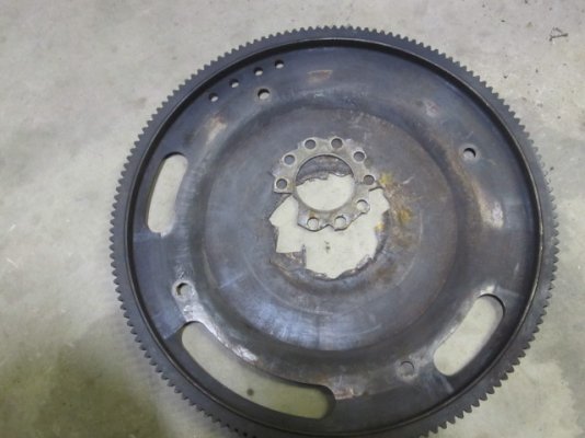

Putting this truck back together, ft. trans seal went out, found flex plate was trashed may have contributed to demise. New R&D HD turbo flex-plate kit will solve that problem. Trans rebuilt again, #3, twice by PO.
Looking for a check list of things to check before trans goes back in, mainly electric, checks like tack sensor, speed sensor ect. Maybe you trans experts should publish something. Trans got rebuilt with tugger kit and better ft seal and a solenoid pack other than that, builder didn't do some of the upgrades I asked for, going to pull pan off and see if I can tell if shift kit went in, anything there I can spot with pan off?

Here's a better pic of turbo flex plate with counterweight, must have been that extra Moose pump HP that did it in ;) !
My truck with a Moose pump likes to munch on clutches… so I could believe that…
