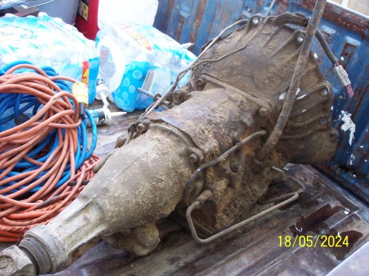

Not that I really needed it, but I picked up what I believe is another FMX transmission. It's kind of hard to tell under all the grease. I traded a set of extended cab running boards that I didn't want for it. The fluid doesn't smell burnt, so I'm guessing that it's probably good.
