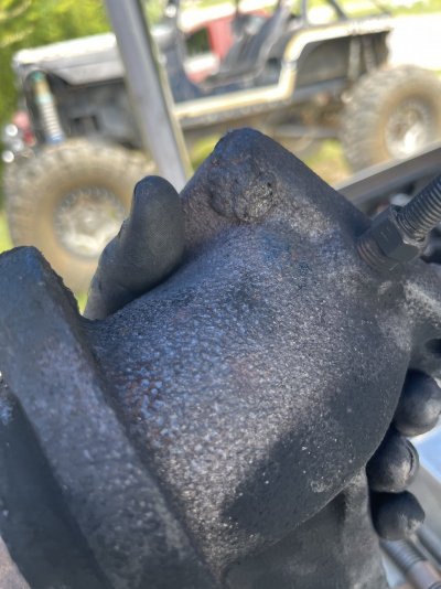

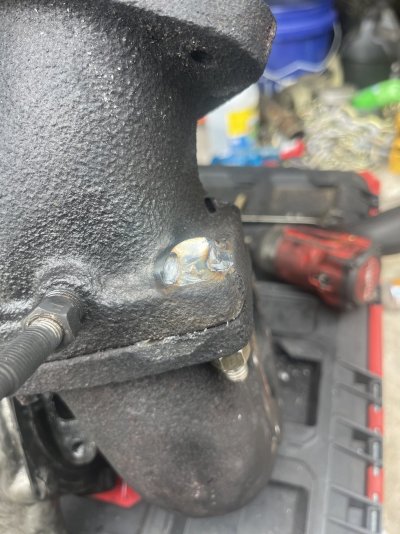

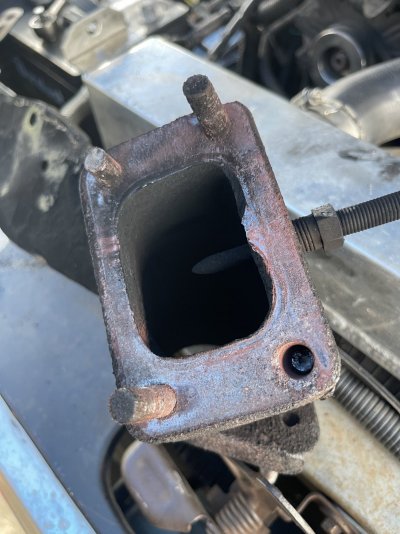

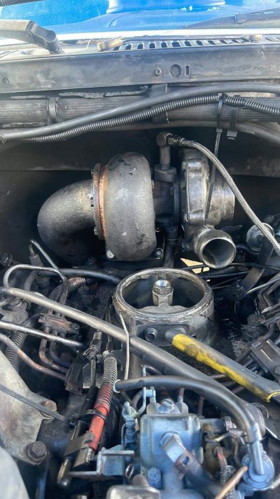

Well, truck overheated on me today and knowing I had bad turbo flange bolts, I got it home, thanks to a buddy with a 7.3 PSD and my gooseneck, and tore it all down. One stud was broke by me yesterday, another one today. Found one of the studs didn’t have a nut on it cause a previous owner had boogered the threads up and another has been booger welded back in.
Got the studs out, installed Grade 8 bolts instead with copious amounts of anti-seize, and got it all back together. Happened to find the unplugged oil pressure sensor when I was re-routing all the lines and putting stuff back together.
Found the leak that caused the overheat. Pinhole leak next to the heater hose clamp coming out of the block. Made the repair easier as I just trimmed the hose back.
Turbo has been changed by a previous owner as well. Whomever it was, they put a non-wastegate Rotomaster t04b35 on there. Turbo is in good shape, and whistles a good bit.
@Jesus Freak, don’t come for the 6.9 just yet. She’s not done ******* me off yet. Lol

So it is possible to remove the turbo from the up-pipe flange without disconnecting anything else? One of the four nuts looks really difficult to get a wrench on...
R Squared
Apr 15, 2023
23
74
Florida
I had to pull the whole mount assembly due to the hardware being seized. I could probably do it now but I wouldn’t. It’s 2 bolts on the back of the trans, the down pipe, and the up pipe and she’s off. From there you can pull it apart on the bench.
15,051
14,149
And this is a different set up than you have. That may make a difference.
