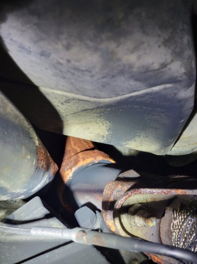

So I've been daily driving my truck while my car is getting service done, this morning heard a loud bang below the drivers floor board. Crawled under it after I got to work, looks like a rock or something flung up is all, nothing crazy.
While I was under there, I took a peek at the exhaust. So far my glued on crossover pipe and shoddy down pipe aren't leaking. But then there's this bad boy. I hate these slip joints. Eventually I'll have to get that mod done to v band clamp it.
