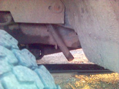

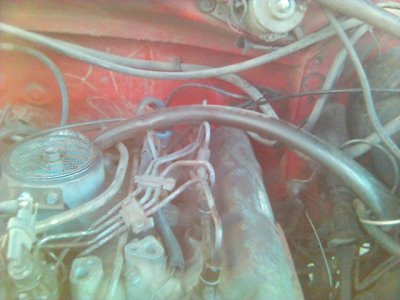

Best I can do with a cell phone, I forgot to grab one of the blockoff:D

that's in the valleypan? :confused: i have a blockoff plug for that, i thought mabe there was a way to get one on the oil fill tube.....
