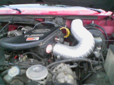

Heres my $10.00 cowl air setup. As everyone has said, I noticed lower EGT's at low and mid range RPM, and higher boost at high RPM. I can tell when its not on there. If I were to do it again, I think I'd go with a ram air through the grill so I dont have to cut a hole in the cowl.
