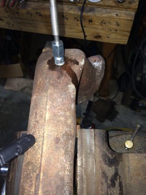

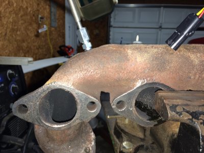

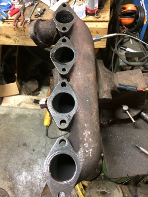

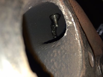

Isspro Thermocouple install: "R" drill bit and 1/8"-27 NPT tap. Put in da thermocouple and adjust it so the tip is in the middle of the exhaust flow ;Sweet
Be careful how far "around" on the manifold you put the thermocouple if you put it at #8 like I did. It is very close to the firewall of my truck as it sits now. I did it while the manifold was off and it about didn't fit once installed.
