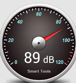

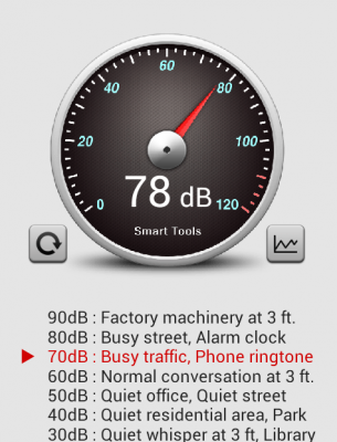

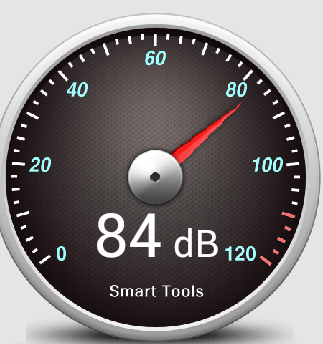

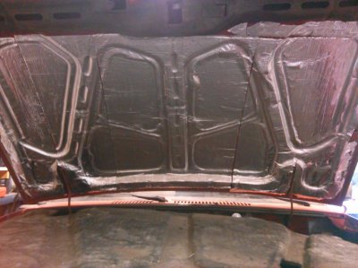

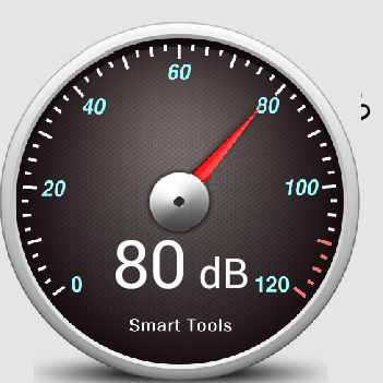

I dowloaded a db meter for my phone and took some before and after measurements. So far I have only done the underside of the hood, and here are the results. I'll post more results as I add more deaden-er to the cab.
anyway, these are the results with a bare cab, and before and after putting a layer of deadening under the hood blanket, ill try to put the pics in order.
we have outside the truck before doing the hood.
inside the truck before doing the hood.
outside the truck after doing the hood.
and inside the truck after doing the hood.

Neat idea... I'll have to do the same thing. 80 dB is a lot.

got the firewall done, I did the complete cab side and also a little bit on the engine side.
Netted me another 2db.

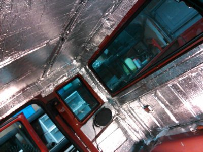

got the roof and the back wall done. Looks like its ready for a moon landing!
Now I just need to get the headliner back in so I can take another measurement.

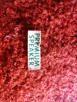

But hey, the good news is I guess the truck has "premium" speakers. This label fell off when I removed one to get the deaden-er in Hahahah, man if I had know that, I woulda paid double for the truck!:D SCORE!

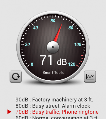

Well doing the roof and back wall didn't improve my readings. I kind of expected that. Seems like this will help with road noise more than engine noise.
the big win was the floor pan and the trans tunnel. After doing those, and putting the padding and vinyl flooring in, I'm reading 71 @ idle. So it seems like this stuff does work. Although my tests do leave out a bunch of useful info. I never took a reading with the full stock interior installed all by itself, so I'll never know how much of my sound blocking is from the interior, and how much is from the deadening. Oh well, I just thought it would be cool to see how it changed things. I expect it will be even better once the seats are back in, and I still plan to do the doors, and the inner fenders.
