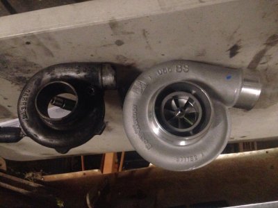

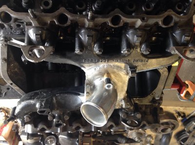

Here's the hair dryer I'm putting on mine and intake
that looks like a 093 housing on the left? whats on the right??
my intake will be a bit more elaborate.
i will be deleting the center cross over.

In the turbo photo maybe an S66 on the right
