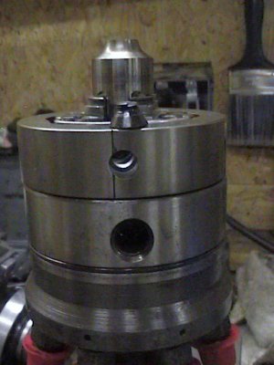

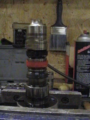

Here is what a broken drive shaft looks like. The fuel increase screw was turned in to far, actually broke the screw head off.

We got the pump today and went right to work on it. It was indeed a problem with the snap ring. One of those weird situations where despite inspection and quality testing (we do push ******* the shaft from the inside during assembly to make sure the snap ring is holding) it somehow worked its way out of the grove in the shaft. This would explain all the running problems you were having, since the snap ring was interfering with the governor weights. The good news is, there really isn't any damage, but the pump is being completely rebuilt and should be sent out today. I sent a PM and am compensating you a little for the hardship. We know that there really is no way to pay for the frustration this has caused, and you have our sincere apologies that this has happened.
Many thanks Mel for taking a second look at my pump and i aprecciate the help and hardwork you have put into it. You will surley be getting my business in the future.
I also want to thank those who have commented and helped with how they could!
Hopefully this thread can help someone in the future.
thanks all, Mark
