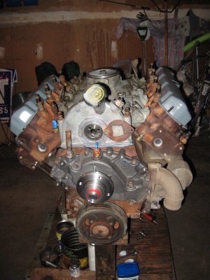

Some time back about 2 weeks ago a question was asked about an oil return fitting possibility in the heads. The answer is yes... All the heads have a 1/4 inch pipe plug in them. That thread is tapered and is 18 threads per inch. This opens directly into the return oil flow from the heads to the oil pan. I hope this is useful information and sorry for taking so long getting this info out...
