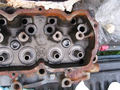

Just spending some quality time with my motor and was looking for the oil drain back holes under the valve covers. There don't seem to be any.
I know the oil flow to the rockers is pretty minimal, but there has to be somewhere for it to go besides into the exhaust system.

never had a look at an idi head but there definately should be somewhere for the oil to drain back down as the oil flow is not as minimal as you would think espeacially when you fire up one with out the covers on

Here's what you're looking for on the bottom, right. It's the same on the other end of the head as well.

very good. My lighting is not quite up to ***** in the garage. I knew there had to be a drain somewhere.
682
Yep... Thats the drilled drainback hole. Kinda hard to locate too. Check the hole in the head gasket next.....

Thanks for that awesome pic, suv7734! I am replacing the valve cover gaskets on mine and I could not find a dang hole. I could stick my screwdriver in the hole shown in your pic, but everything is so black back there that even with a drop light and a flashlight and a mirror, I could not see it. Your pic confirmed that my screwdriver was, in fact, going into the drainback hole, so I can go ahead and button it back up. Just wanted to make sure the hole was clear of crud. Thanks!
