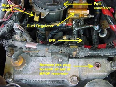

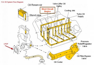

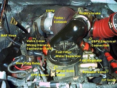

Your fuel leak/smell is prolly coming from the drain valve on the filter, the orings start leaking. A new valve is around $62, o'rings about $2.00. IH has them. I think the pics I'm posting are for the 96, may help.
Visit this for part numbers and other things. http://www.oilburners.net/forums/forumdisplay.php?f=81
