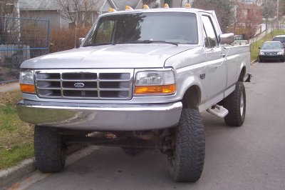

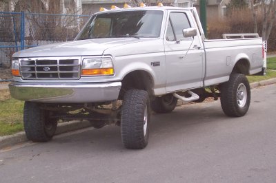

New to me 93 f-350 4X4 5 speed , 94 turbo engine installed in the truck buy the previous owner. 6 inch super lift riding on 35"S now. going to make an intake today and remove the whole old box. Any sugestions for more power would be nice.

Nice looking truck. How does it ride on the superlift springs? I have been looking at the different options for lifting my truck but haven't gotten much if any feedback on the different springs available.

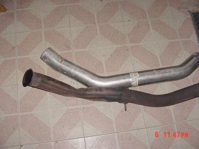

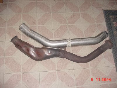

"Finished" my intake today will post a couple of pics later, consistof a 3.5 inch 90 right of the turbo flex coupler then 2.5 feet ish of pipe on an AFE filter. Right now it's a hot air intake but will be fixing that soon enough. Stock down pipe looks like what compared to an ats one??

the pipe looks like someone ran over it and then they put it on there.

looked at my down pipe today doesn't look loke some one ran over it but there is a small section between firewall and tranny that is "crimped" 3/4 of an inch is this stock or is stock totaly crushed??

It sounds to me like you have the stock downpipe. Here is a picture of the stock next to the ATS pipe.

Didnt realize how noticeble the holes in the bumper were until i saw the picture of your truck........it definitely makes it look like gasser without the diesel bumper. Missing the badges too:dunno
