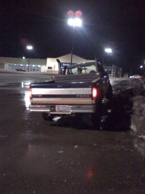

edit: Hey sootman you have 4" stacks on your truck, do you have any pics?

yea heres the best ones i have with me at school.
