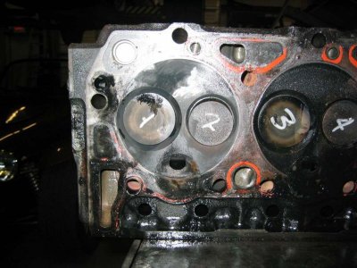

So what does it mean if the boost is steady or jumpy?
-Rob
If you,ve got a valve guide that looks like #2 (pic by Jaybee) you will see the boost gauge 'flutter' or pulse ever time that cylinder 'fires'. The exhaust will also enter the valve cover causing a 'puff' in the blowby. The excess crankcase pressure can also cause seals to start leaking (rear main is common). In the case of an exhaust valve eventually the spring will lose its temper due to the heat and it's all downhill from there.

Well I guess that means it probably not a valve guide. The noise sounds heavier and louder than a I would imagine a valve could make. So I guess that narrows it to wrist pin or rod bearing. I doubt a lifter would make a nois this loud either.
Is there a way to check for a bad wrist pin or connecting rod bearing by pulling the oil pan or something?
-Rob
