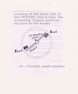

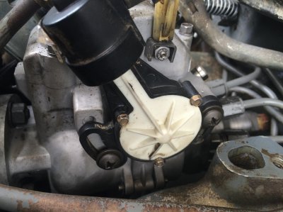

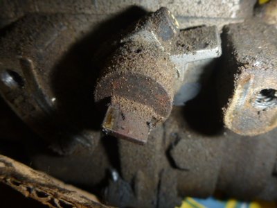

The VRV operation/rotation is driven with a pin as opposed to the TPS tab (pic) drive, but both must be like in the pic showing the driven knobs.
