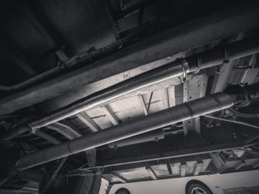

Hey guys! I am looking to get a muffler for my 7.3 IDI NA. I went straight-piped a while back and liked it at first, but it's straight up obnoxious and gets on my nerves now! I'd like to keep the lower tones and cut out the raspy bite. Let me know if you have any recommendations!

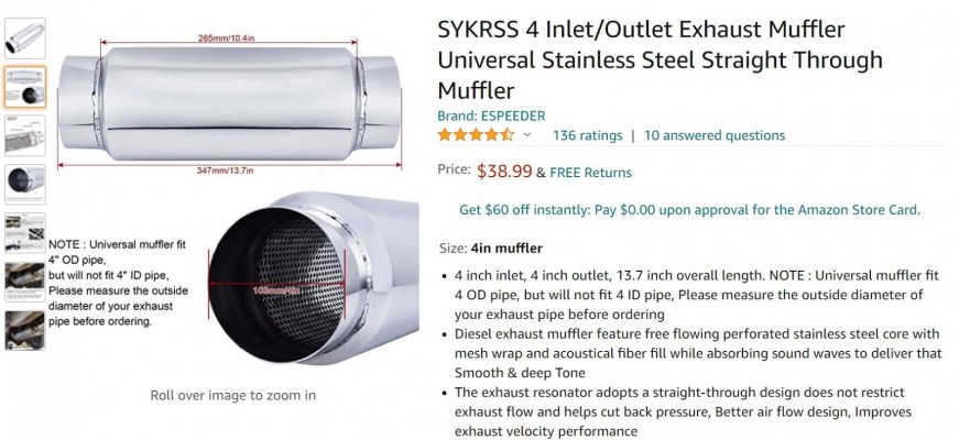

Days back when I threw away my truck's rusted (and likely partially clogged) muffler I was going to install something like this one on photo below.
But, after talking to a friend who has installed similar muffler and listening to his exhaust sound I was not convinced - that muffler was entirely eliminating higher frequency sounds so that I could not hear turbine spinning at all. Maybe it's my loss of hearing. But with straight pipe I can hear turbo working properly. Again, maybe it is just personal perception and hard of hearing, but I found straight pipe not too loud with 6.9 IDI turbo.
