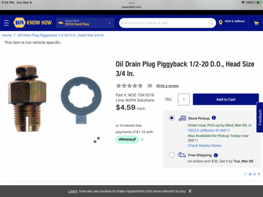

There should be like a washer that reenforces the pan in the oil plug area. It is thin but can catch a few threads. Have to be careful with a tap, I believe the oil pickup screen is just above drain. Can shine a light or use something soft to check for clearance.
gnathv
Oct 18, 2007
1,062
532
Athens, Al
Or something like this. Clean really well, epoxy and double wrench when you change oil.

you might want to try wrapping it with Teflon tape....that has worked for me in the past....
